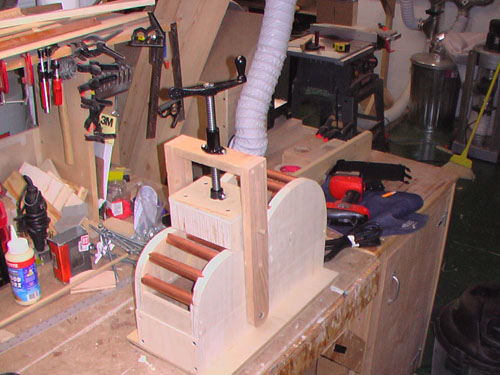

For what it's worth, I built my own bender as well and used three 150w heat lamps with the ceramic bases.  I think that eventually I'll go with the blanket too, per everyone else's recommendations.  Not shown in the pic are the front and rear clamps, guess I took this pic in mid-assembly, sorry! And no, the dust collector hose is NOT hooked up to it.
The whole deal, including the press screw, only set me back about $40.00.  Best of luck!
Jon

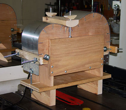

I used a heat blanket for the first time Wednesday, here`s the results. I shall also be using a heat blanket in my home made Fox bender later this year for my first steel string build. I must say I`m really impressed at how easy it is to bend with a heat blanket. Now I`ve successfully used a heat blanket, don`t want to go back to a bending iron. Wish this blanket was a couple more inches longer though.
Here`s the side in the form.
